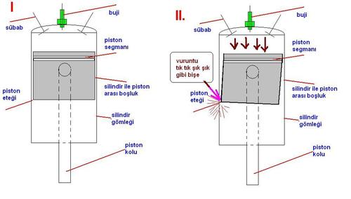

Re: Woher kommen diese Geräusch? - Thumbnail von watchtech watchtech - 15.04.14 01:53 Uhr Klicks:52
Definitely, a sound from the piston. The sound of the piston skirt. large cylinder. small and worn piston. New and original with the piston. This problem will be solved.
Gruss watchtech
http://www.hilfsmotor.eu/galleryimages/doTFHGJW.jpg
